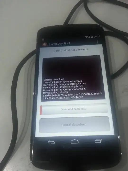

I faced the same issue on ubuntu 13.04 with nexus 4, I failed to install sudo apt-get install ubuntu-device-flash so I tried to root the device using Ubuntu Nexus 7 Desktop Installer and I followed the instruction here DualBootInstallation. i worked ;)
