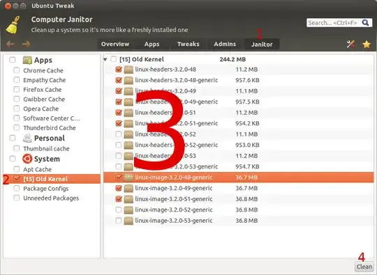

You can try Ubuntu Tweak to clean old kernels. First install it using these commands
sudo add-apt-repository ppa:tualatrix/ppa
sudo apt-get update
sudo apt-get install ubuntu-tweak
Run the program and then:
  1. Select the "Janitor" tab
  2. Select the "Old Kernel" checkbox
  3. Select kernel versions to remove (keep 2 at leats - just in case)
  4. Press "Clean"
