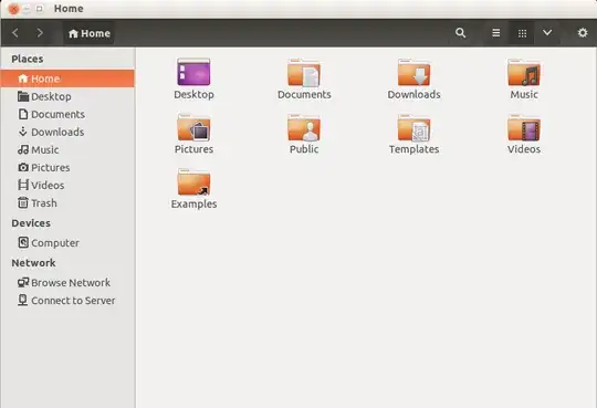

The result in Nautilus:

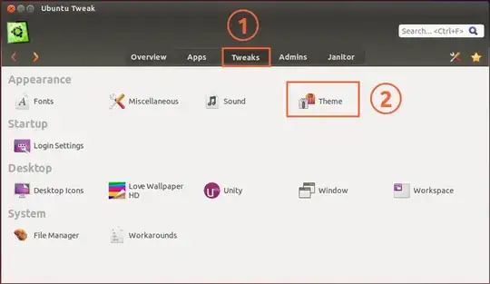

Ubuntu-Tweak
To install ubuntu-tweak you can add this ppa.
1) Open a Terminal window Ctrl+Alt+T and type:
  • sudo add-apt-repository ppa:tualatrix/ppa
  • sudo apt-get update
  • sudo apt-get install ubuntu-tweak

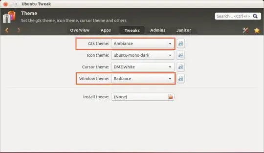

2) Open the Ubuntu-Tweak and go to Tweaks -> Theme.

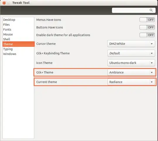

Gnome-Tweak-Tool
To install the gnome-tweak-tool
  • sudo apt-get install gnome-tweak-tool
2) Open the gnome-tweak-tool application and go to Theme.
NOTE: In this application the window-theme is named as Current Theme.
