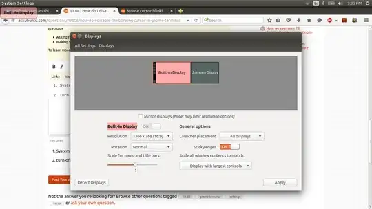

This worked for me. System Settings > Screen Display. There is an unknown monitor. Disable it, it should be good. This is not my solution, i got it from here. https://askubuntu.com/a/360473
Cruz
  • 266
  1. Go to System Settings > Displays.
    a screenshot of Displays, in System Settings, showing Built-in Display and Unknown Display
  2. Turn-off / disable Unknown Display.
