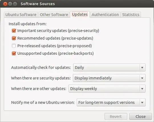

Run the update manager select Preferences and make sure Notify me of a new Ubuntu version is set to For long-term support versions as shown.
You will then not be notified of a new version until April 2014 and you can choose to update at any time you choose from then until support runs out in 2017.
