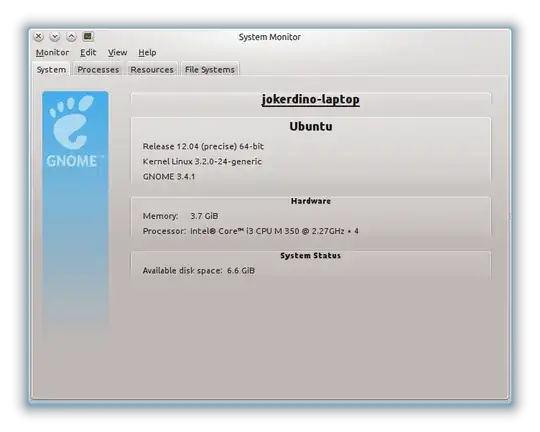

if you don't want to open a terminal, you can view your kernel version using gnome-system-monitor. Look for the system monitor in the menu and look in the first tab System.
jokerdino
  • 41,732
