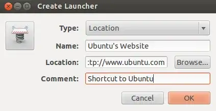

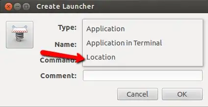

Try this. Install Gnome Panel, just press Ctrl+Alt+T on your keyboard to open Terminal. When it opens, run the command(s) below:
sudo apt-get install gnome-panel
Once installed type this:
gnome-desktop-item-edit --create-new ~/path/to/shortcut
(location of shortcut). In the example below, I will create a shortcut for Ubuntu.com and place it inside the Documents folder. Once I hit Enter a window will open with the properties. See images below.
gnome-desktop-item-edit --create-new ~/Documents
Once done, just click on them newly created shortcut.

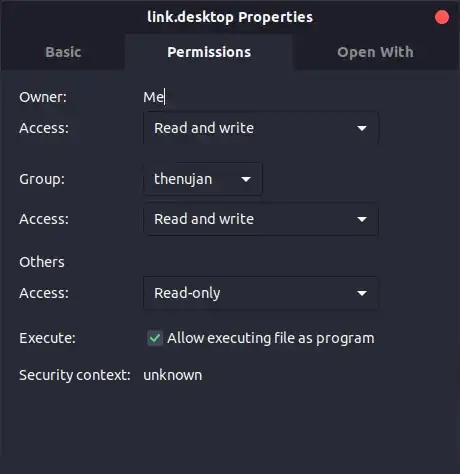

and then right click the file and select Allow Launching:
Allow launching
If the Allow Launching option is not there:
  • Click Properties and click the Permission tab.
  • Change Others access to read only and group,owner access to read and write, and;
  • Don't forget to tick Allow executing file as a program.
Properties
Allow Launching should be visible now so click it and there you have your shortcut.
