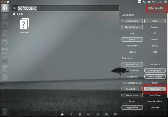

After having entered the search term in the text field of the Dash we can filter the results to include manpages as a search source:
This will then display manpages of all installed applications. Selecting the manpage will display its content with Yelp.
