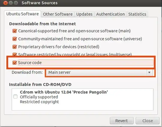

1) Make sure you have enable the Source code repository
  • Open the Ubuntu Software Center.
  • In the Menu Bar choose Edit -> Software Sources. Click to enable "Source code repository". Just in case I use the "Main Server" to Download.

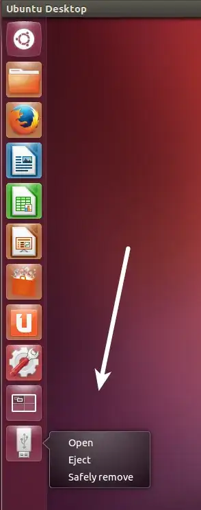

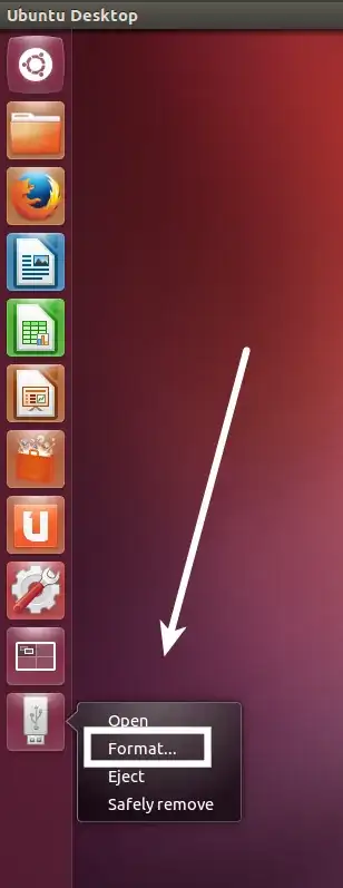

Before:
After:
