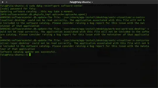

Output from terminal when I type:
sudo dpkg-reconfigure software-center:
Updating software catalog...this may take a moment.
INFO:softwarecenter.db.pkginfo_impl.aptcache:aptcache.open()
WARNING:softwarecenter.db.update:The file: '/usr/share/app-install/desktop/sonic-visualiser:x-sonicvisualiser.desktop' could not be read correctly. The application associated with this file will not be included in the software catalog. Please consider raising a bug report for this issue with the maintainer of that application
WARNING:softwarecenter.db.update:The file: '/usr/share/app-install/desktop/workrave:workrave.desktop' could not be read correctly. The application associated with this file will not be included in the software catalog. Please consider raising a bug report for this issue with the maintainer of that application
WARNING:softwarecenter.db.update:The file: '/usr/share/app-install/desktop/sonic-visualiser:x-sonicvisualiser-layer.desktop' could not be read correctly. The application associated with this file will not be included in the software catalog. Please consider raising a bug report for this issue with the maintainer of that application
Software catalog update was successful.

According to warning it seems to be a bug because some of the apps in repositories didn't updated/read correctly. As the post suggest you should consider to launch a bug.
But before that it is not bad to give a try to fix the problem. I suggest you to completely remove software-center and install it again, if you don't mind.
