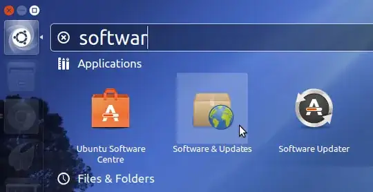

In 13.04, it was renamed to "Software and Updates". It is the same application, just with a different name.
Screenshot below: Software & Updates in the Unity Dash
