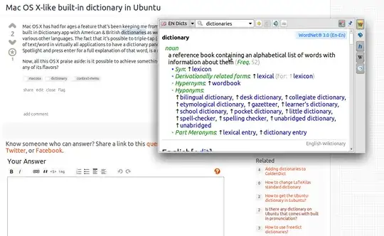

Check out GoldenDict. It's one of my favorite pieces of software. Cross-platform compatible dictionary look-up! It's highly customizable and compatible with a plethora of different dictionary formats and pretty much any website out there (e.g. wikipedia, dict.cc, etc.):
You can either install it from the USC or get one of the latest development releases from the OpenSUSE build repository (e.g. for 12.04 LTS/amd64).
As far as dictionaries are concerned, I'd suggest you install Wordnet 3.0 to get started. Some notes on supported dictionary formats and where to find them may be found here.
