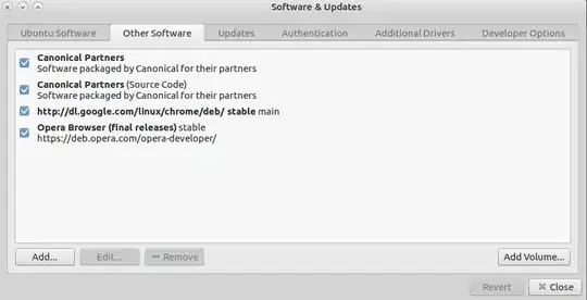

Native Skype on Ubuntu
There is a native Skype client for Ubuntu. You can open the Software and Updates applet included All Ubuntu flavors and click on the tab that says "Other Software". Make sure the Canonical Partners is ticked. Then you will be able to install the program through your favorite standard Ubuntu install method (software center, synaptic, or terminal).
or simply type:
sudo apt-get update
sudo apt-get install skype
enter image description here You can download it from the Skype for Linux download page. Choose the Ubuntu 12.04 version from the list of distributions.
This is by far the easiest way to install Skype on Ubuntu, but there are some disadvantages to this version, the main one being that Group video chat, or video conferencing is disabled. Video Chat between just two people works.
