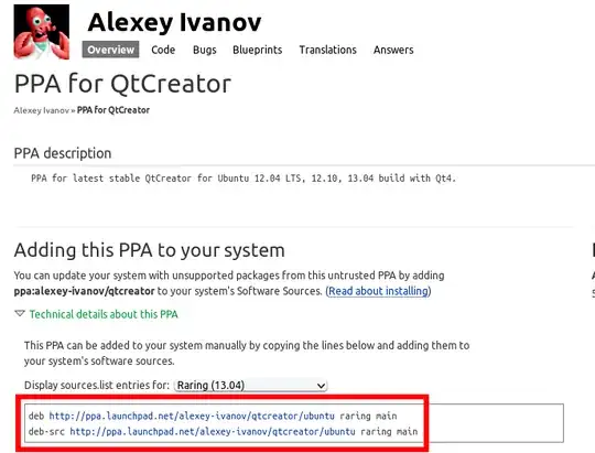

Assuming you prefer the easier, just search in launchpad the package you want and you probably will find a PPA for what you're looking for. Here's Qtcreator PPA https://launchpad.net/~alexey-ivanov/+archive/qtcreator
PPA
To install it, add the lines highlighted in the image
deb http://ppa.launchpad.net/alexey-ivanov/qtcreator/ubuntu raring main
deb-src http://ppa.launchpad.net/alexey-ivanov/qtcreator/ubuntu raring main
in the end of your /etc/apt/sources.list file and run sudo apt-get update && sudo apt-get upgrade. Don't forget to change the raring to whether Ubuntu version you're using.
