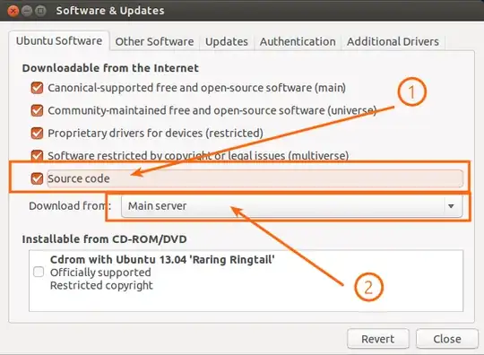

1) Make sure you have enable the Source code repository.
  • Open the Ubuntu Software Center.
  • In the Menu Bar choose Edit -> Software Sources. Click to enable "Source code repository". Just in case I use the "Main Server" to Download.

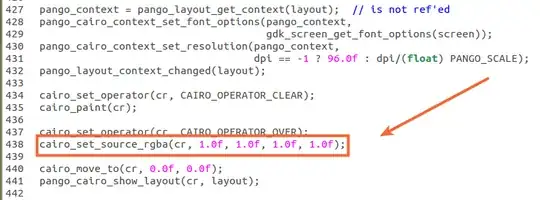

  • quilt edit dash/ResultRendererTile.cpp
Edit the Line 438.
I changed it from:
  cairo_set_source_rgba(cr, 1.0f, 1.0f, 1.0f, 1.0f);
To:
  cairo_set_source_rgba(cr, 0.0f, 0.0f, 0.0f, 1.0f);

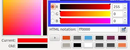

You can choose your color with the typical RGB color selector in graphic software, like Red:
(Red,Green,Blue) (255, 0, 0)
In Arithmetic notation would be:
255/255 = 1.0f
  0/255 = 0.0f
  0/255 = 0.0f
So, if you want the text-color Red:
  cairo_set_source_rgba(cr, 1.0f, 0.0f, 0.0f, 1.0f)

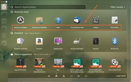

Before:

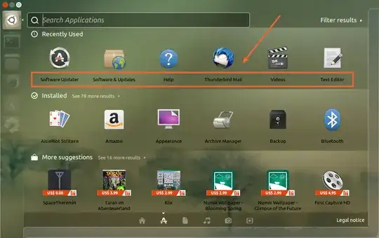

After:
