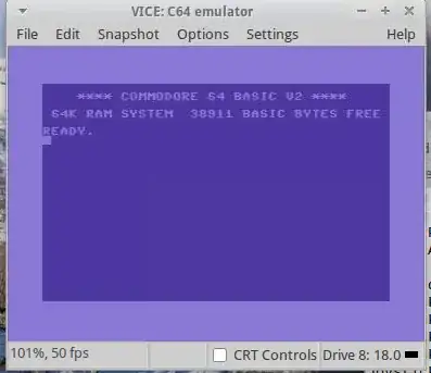

6) type x64 and Enjoy! (this thing evokes a tear... my first computer ever was a C64. If only I did not lose my discs...)
vice x64 running
