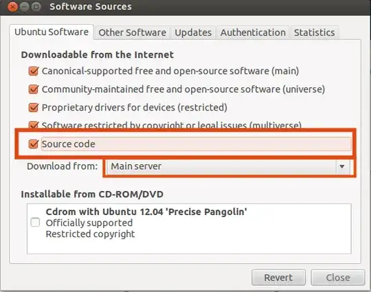

1) Make sure you have enable the Source code repository.
  • Open the Ubuntu Software Center.
  • In the Menu Bar choose Edit -> Software Sources. Click to enable "Source code repository". Just in case I use the "Main Server" to Download.

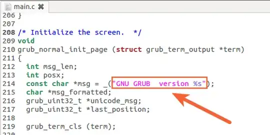

Edit the main.c file
  • quilt edit grub-core/normal/main.c
As an example I changed the line 214
From:
  const char *msg = _("GNU GRUB  version %s");
To:
  const char *msg = _("My Custon Grub Title");

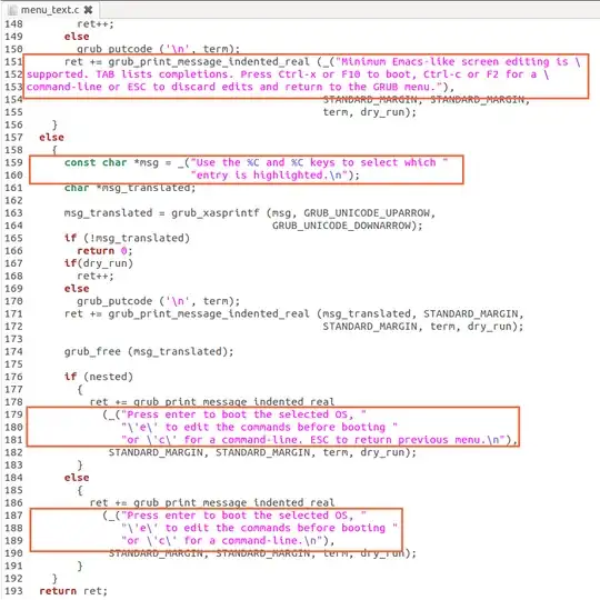

Edit the menu_text.c file
  • quilt edit grub-core/normal/menu_text.c
Edit the "Strings" (Pink Color) According to your needs.
Only as an example I changed the lines 159 & 160
From:
  const char *msg = _("Use the %C and %C keys to select which "
          "entry is highlighted.\n");
To:
      const char *msg = _("You can write a text message here according \
to your needs...\n");
And the lines 187 to 189
From:
(_("Press enter to boot the selected OS, "
   "\'e\' to edit the commands before booting "
   "or \'c\' for a command-line.\n"),
To:
        (_("You can put a message here... to press \
a key to boot the OS.\nOr a Help text... etc."),

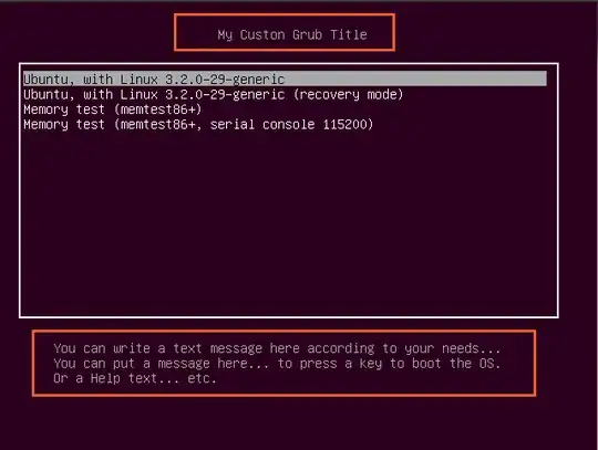

9) Finally you can Restart your machine to see the changes.

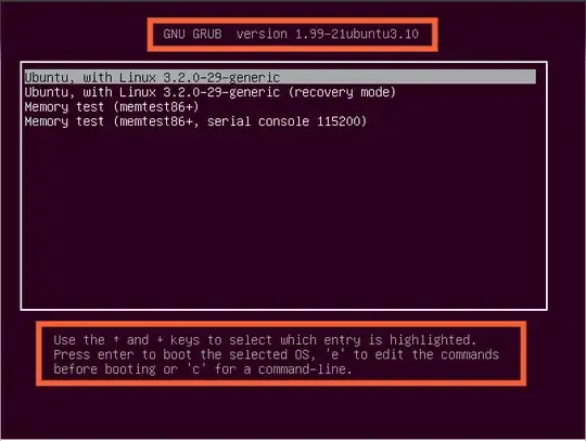

Before:
After:
