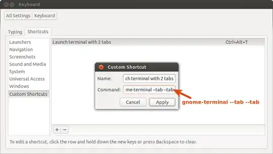

If you want to open gnome-terminal with more than one tab when you open it using Ctrl+Alt+T shortcut, go to System SettingsKeyboardShortcutsCustom Shortcuts and add a new Ctrl+Alt+T shortcut as follow:
custom shortcut

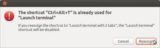

Select Reassign when you are asked:

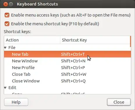

Now, to open a new tab in gnome-terminal, you can use Ctrl+Shift+T. To access/view/edit your terminal shortcuts go to EditKeyboard Shortcuts...:
terminal Keyboard Shortcuts
