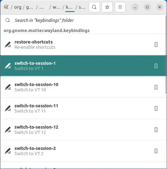

On Gnome Wayland you can unset the keybindings for virtual terminal switching by setting these dconf properties:
dconf write /org/gnome/mutter/wayland/keybindings/switch-to-session-1 "['']"
dconf write /org/gnome/mutter/wayland/keybindings/switch-to-session-2 "['']"
dconf write /org/gnome/mutter/wayland/keybindings/switch-to-session-3 "['']"
dconf write /org/gnome/mutter/wayland/keybindings/switch-to-session-4 "['']"
dconf write /org/gnome/mutter/wayland/keybindings/switch-to-session-5 "['']"
dconf write /org/gnome/mutter/wayland/keybindings/switch-to-session-6 "['']"
dconf write /org/gnome/mutter/wayland/keybindings/switch-to-session-7 "['']"
dconf write /org/gnome/mutter/wayland/keybindings/switch-to-session-8 "['']"
dconf write /org/gnome/mutter/wayland/keybindings/switch-to-session-9 "['']"
dconf write /org/gnome/mutter/wayland/keybindings/switch-to-session-10 "['']"
dconf write /org/gnome/mutter/wayland/keybindings/switch-to-session-11 "['']"
dconf write /org/gnome/mutter/wayland/keybindings/switch-to-session-12 "['']"

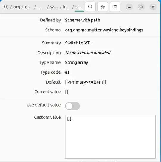

It can be disabled in dconf-editor too:
  1. Search "switch-to-session", in dconf-editor;
  2. Select each item of "switch-to-session-1" to "switch-to-session-12";
  3. For each item, turn off "Use default value", and set "Custom value" to "[]";
Search in dconf-editor:
search in dconf-editor
Set custom value for each item:
set Custom value for each item
