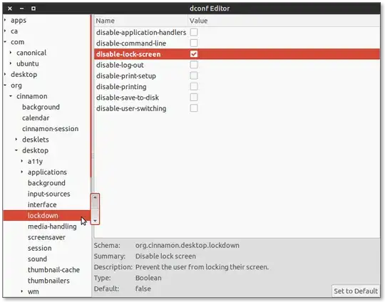

After a bit of searching in dconf-editor (inspired by the other answers and not gconf), I found the schema
org → cinnamon → desktop → lockdown
which contains a key called disable-lock-screen, set that to true (checked) to disable the Cinnamon lock screen.
dconf-editor screenshot here
Command Line
To turn lock screen off:
gsettings set org.cinnamon.desktop.lockdown disable-lock-screen true
To turn back on:
gsettings set org.cinnamon.desktop.lockdown disable-lock-screen false

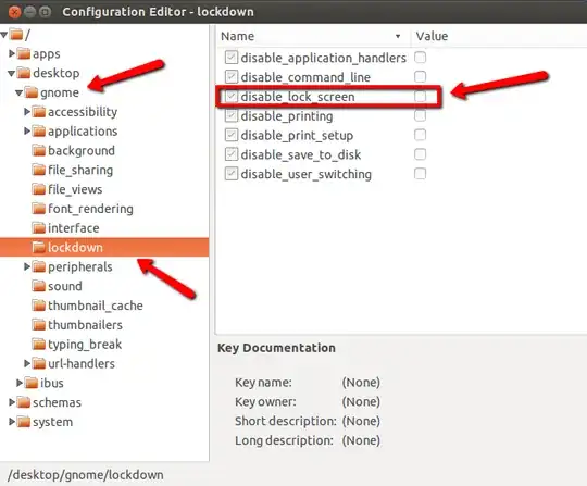

After installing Cinnamon the way you did, and running it, opening gconf-editor, I coudn't find a cinnamon entry under desktop, only gnome. You can disable the Gnome lock screen, and see if that helps.

you have to install gconf editor for that. after install gconf editor , open it navigate as desktop - cinnamon - lockscreen or desktop - gnome - lockscreen . there you can disabled the cinnamon lock screen.
I think cinnamon using gnome lock screen.
try it.
