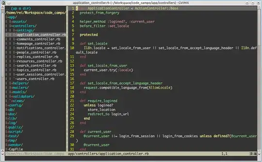

I'm running Xubuntu 13.04 and I want to use Vim as my default editor for everything. I have downloaded many vim color schemas and tried them out, but all of them don't look like the official screenshot.
For example, vim's own color schema - desert should look like this:
Should look like this

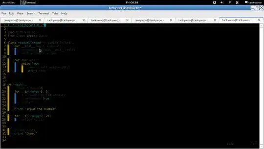

But in my vim, many colors won't display, for example the background.
So this means a fighting with xfce's Terminal and I can't force it to use 256 colors. the command tput colors gives me 8.
