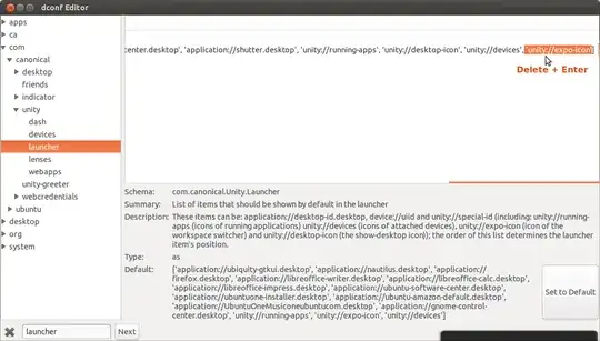

First install dconf-toolsInstall dconf, if you don't have it already installed.
Then open dconf-editor (search for it in the Dash) and browse to comcanonicalunitylauncher, and edit the favorites field by removing the , 'unity://expo-icon' string:
dconf-editor
After this, your Workspace Switcher icon will disappear from the launcher.
