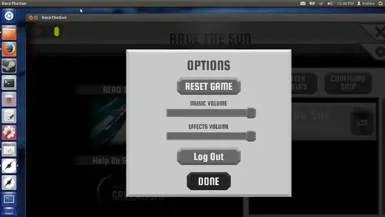

I have been playing "RaceTheSun" on Ubuntu 12.04 using Unity-3D(desktop) with Compiz.
However, It seems It does not have an option to go full screen, neither in the game options or on the window controls.

However this seems only to resize the window size, the window still has decoration and the launcher/top-bar still show over the application.

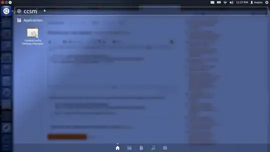

  2. Open compizconfig-settings-manager from dash:

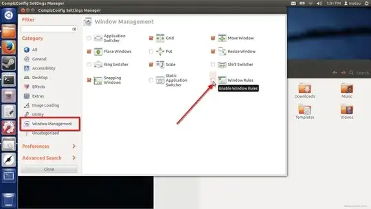

  3. Go to → Window Managment → Window Rules → Check "Enable Window Rules" enter image description here

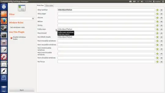

  4. Enter title=RaceTheSun into the field: Fullscreen (since it seems RaceTheSun does not use WM_CLASS we rely on the title field) enter image description here
