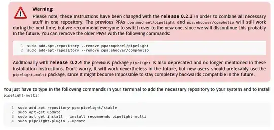

Remove and get the latest version from their official website, fds-team.com
there's a bit different from previous version and please read carefully on the instruction given. website is outdated.
