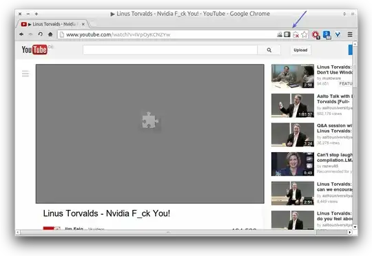

From now on if you navigate to a YouTube video page you should see a small Minitube icon on the right side of your address bar:

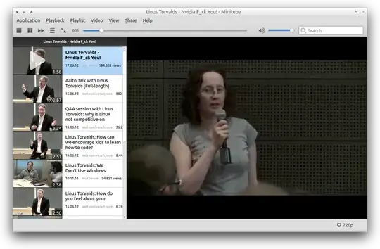

Clicking it will launch Minitube and play back the video or - if Minitube is already running - switch playback to the video in question:
