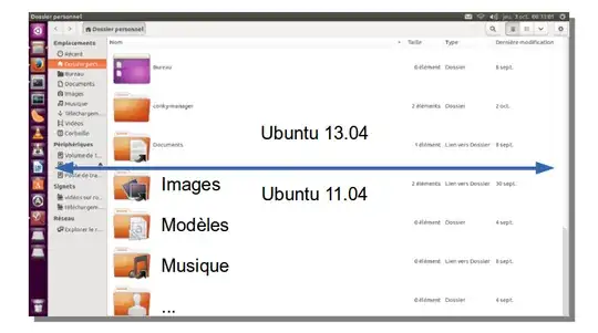

I'm looking to edit the way for nautilus to handle the zoom.
Since Ubuntu 13.04, when you use the zoom in nautilus it only changes the thumbnails/icons size, and the filename text stay the same.
Is there a way to make the zoom function change the size of the filename font?
In image: Differences in nautilus zoom, Ubuntu 11.04 / 13.04
I tried to look for a hidden option inside dconf-editor (org.gnome.nautilus.*) but nothing concur to what I'm looking for.
Any tips !?
Notes: I'm using a desktop version of Ubuntu as 'Tv' that I control from my couch, when I was on Ubuntu 11.04 I could simply zoom at 200% and read the filenames easily from the distance, but now, it's just the icons...
There is also the exemple of my father who have a poor sight, the old zoom function was perfect for him too.

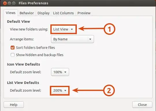

First of all, I set the Nautilus Prefereces in "List View" as Default View and "200%" the zoom in List View Defaults.

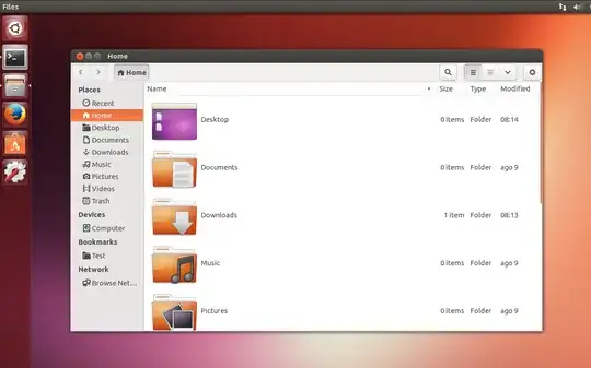

By default the result with no scale font would be:

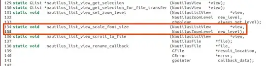

After line 133 add:
static void   nautilus_list_view_scale_font_size                 (NautilusListView        *view,
                                                                  NautilusZoomLevel  new_level);

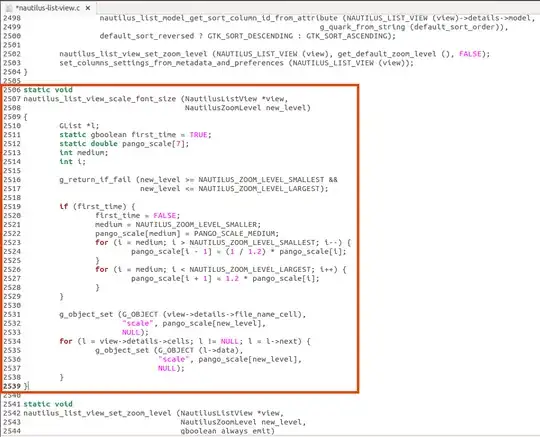

After line 2506 add:
static void
    GList *l;
    static gboolean first_time = TRUE;
    static double pango_scale[7];
    int medium;
    int i;
    g_return_if_fail (new_level >= NAUTILUS_ZOOM_LEVEL_SMALLEST &&
              new_level <= NAUTILUS_ZOOM_LEVEL_LARGEST);
    if (first_time) {
        first_time = FALSE;
        medium = NAUTILUS_ZOOM_LEVEL_SMALLER;
        pango_scale[medium] = PANGO_SCALE_MEDIUM;
        for (i = medium; i > NAUTILUS_ZOOM_LEVEL_SMALLEST; i--) {
            pango_scale[i - 1] = (1 / 1.2) * pango_scale[i];
        for (i = medium; i < NAUTILUS_ZOOM_LEVEL_LARGEST; i++) {
            pango_scale[i + 1] = 1.2 * pango_scale[i];
    g_object_set (G_OBJECT (view->details->file_name_cell),
              "scale", pango_scale[new_level],
              NULL);
    for (l = view->details->cells; l != NULL; l = l->next) {
        g_object_set (G_OBJECT (l->data),
                  NULL);

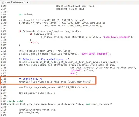

After line 2569 add:
/* Scale text. */
nautilus_list_view_scale_font_size (view, new_level);

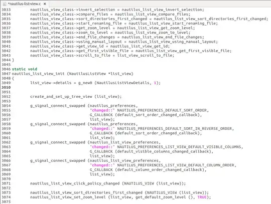

Remove lines 3051 & 3052.
/* ensure that the zoom level is always set before settings up the tree view columns */
list_view->details->zoom_level = get_default_zoom_level ();

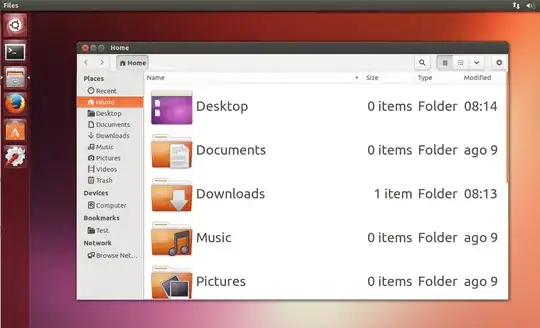

Result:
