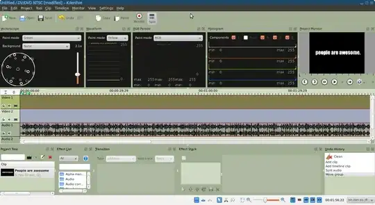

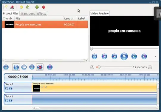

mp4's can be easily edited using both kdenlive and openshot.
If you use kdenlive you may be in the need to have KDE's theme properly configured in order to avoid problems with the menus and other program's items while at work.
I personally prefer the usage of kdenlive.
Transcoding can also be done inside of both these NLES. Or by following one of this suggestions: How can I maximum compress video files?
Screenshots placed here for your convenience.
kdenlive
openshot

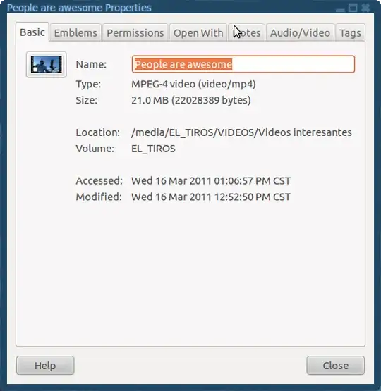

The properties of the mp4 file that I used for this screenshots:
