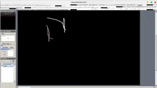

I installed SmoothDraw 4.0.5 with PlayOnLinux on Arch Linux (I know this is exclusively an Ubuntu forum but it should work the same for the most part). I believe I installed the dotnet40 or dotnet45 library during the installation (I definitely installed one of them, if not dotnet45 then I installed it afterwards by going into Settings > Install Components). It should theoretically work with simply dotnet40 but I did not one of the required libraries to be specifically that. I also tried installing mono but noticed something in the logs of it getting removed or something, though it is still installed on my system according to pacman (the default Arch Linux package manager), so I do not believe it is needed. But something that is needed for sure is to configure Wine so that the Windows version is set to "Windows 7". It was set to Windows 3.1 by default I think.
The colors are a little messed up. Choosing a color and/or tool may be a bit cumbersome, but I'm sure that with enough clicking around you can find your way. Also it may be hard to select different colors quickly, like Sal Khan of Khan Academy does in his videos. You can see a screenshot here.
screenshot
Also regarding @An SO User's question regarding a Linux alternative (in the form of a comment on @jobin's answer), I find that the Paintbrush tool in GIMP is quite similar to the Pen tool in SmoothDraw.
