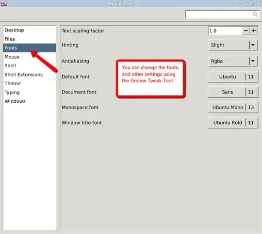

To change the fonts, you can use the Gnome tweak tool. To install it, just press Ctrl+Alt+T on your keyboard to open Terminal. When it opens, run the command(s) below:
sudo apt-get install gnome-tweak-tool
Once installed, run it, and click on fonts to change the default font. See image below.
