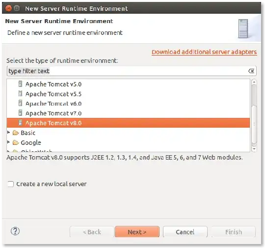

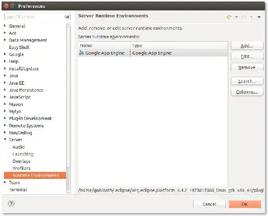

Even though its late, I'm posting this for future readers. I found out there is an easy way of doing that. You can follow this blog post which is providing a step by step guide to do it: Install Apache Tomcat on Ubuntu
Step 1: Open the Eclipse.
Step 2: Goto Windows → Preferences in the menu bar and select the Runtime Environments under the Server.
Step 3: Click on the 'Add' button.
Step 4: Select your Apache Tomcat version under the 'Apache' root and click 'Next'.
Step 5: Browse and select the Tomcat installation directory.
Step 6: Click on the 'Finish' button
Step 7: Click on the 'OK' button to close the Preferences dialog.

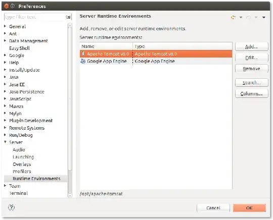

You are specifying tomcat source directory but it needs to specify tomcat binary installation root directory, also known as CATALINA_HOME.
You can download apache-tomcat and untar it there or add a links.
If you untar apache-tomcat in /opt/apache-tomcat-7 you can create symbolic links to its folders.
