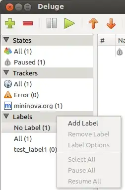

Create a label (or modify it options) by right-clicking on the Labels section in the sidebar:

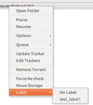

Assign a label to a torrent by right-clicking on the selected torrent(s) and then select your label from the sub-menu:
