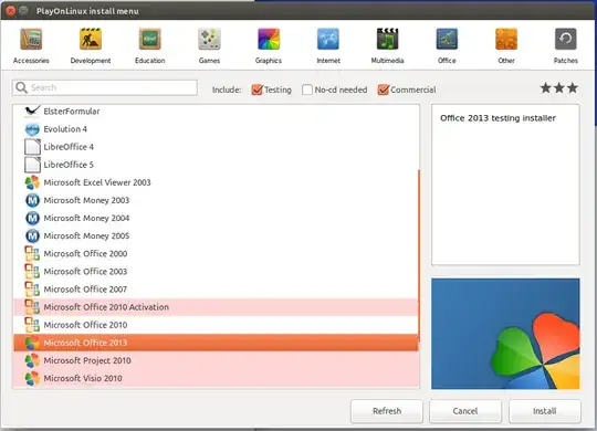

PlayOnLinux beta installer script supports Office 2013. It uses Wine 1.8-staging. PlayOnLinux is a Wine GUI that allows you to install multiple Windows programs on Linux operating systems.
WORKS FOR ANY VERSION OF UBUNTU
It comes with the adequate configuration for multiple applications and games, you have to have only the installer and then follow the program instructions.
For installing it run the following commands:
To add the repository that contains the program:
wget https://dl.winehq.org/wine-builds/Release.key
sudo apt-key add Release.key
sudo apt-add-repository 'https://dl.winehq.org/wine-builds/ubuntu/'
sudo apt-get update
And to install it:
sudo apt-get install playonlinux
Then install Microsoft Office Pack 2013, also works for 2010 and multiple games: enter image description here
