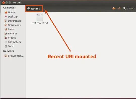

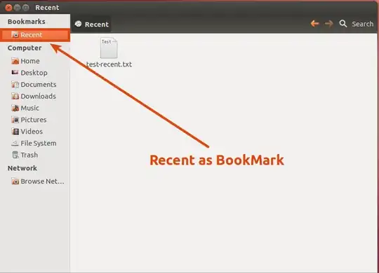

3) Test if you can mount the recent uri.

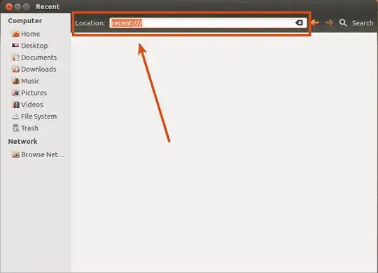

  • Open nautilus, then Ctrl+L, then type recent:/// , then Enter to see if you can mount the recent files location.
Then to add as a Bookmark... in the recent uri mounted just press Ctrl+D.

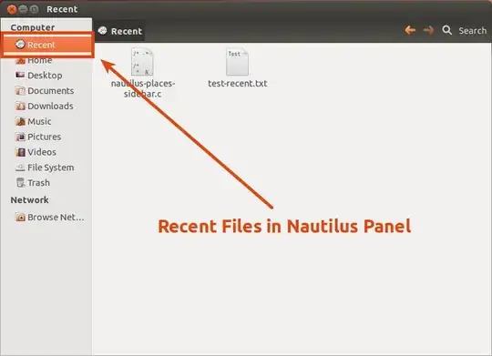

NOTE:Now if you want to add recent not in bookmarks... just in the side panel under computer, above the Home directory like Nautilus 3.6... You should edit the nautilus 3.4 source code.

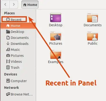

Nautilus 3.6:
Add Recent Files to Nautilus Panel.

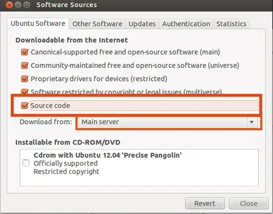

1) Make sure you have enable the Source code repository
  • Open the Ubuntu Software Center
  • In the Menu Bar choose Edit -> Software Sources. Click to enable "Source code repository". Just in case I use the "Main Server" to Download.
Open a Terminal window and type:

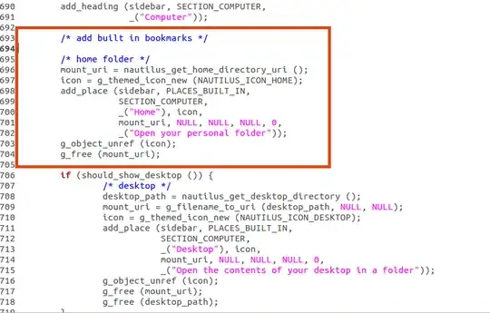

  • quilt edit src/nautilus-places-sidebar.c

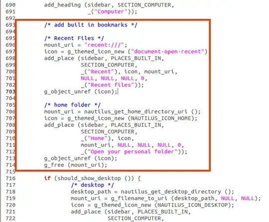

After line 694 add:
/* Recent Files */
mount_uri = "recent:///";
icon = g_themed_icon_new ("document-open-recent");
add_place (sidebar, PLACES_BUILT_IN,
       SECTION_COMPUTER,
       _("Recent"), icon, mount_uri,
       NULL, NULL, NULL, 0,
       _("Recent files"));
g_object_unref (icon);
BEFORE:
AFTER:
Save the changes and close gedit.

9) Finally you can logout and Login to see the changes.
RESULT:
