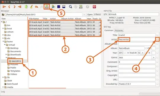

Actually with EasyTAG you do not need to set (example) the Album name file by file in the same directory.
You can try this:
  1. Open the EasyTAG and navigate to the folder you want.
  2. Select all the files with Ctrl+A.
  3. Write the Album Name.
  4. Click in the checkbox to apply the same Album name to all the selected files.
  5. Save the changes to all the selected files.
screenshot

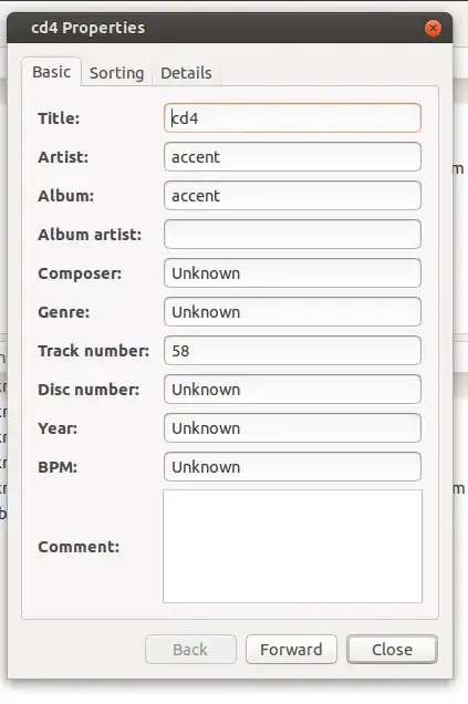

Without installation, you may use rhythmbox to do it open the file with rhythmbox and right click > Properties and then do it
