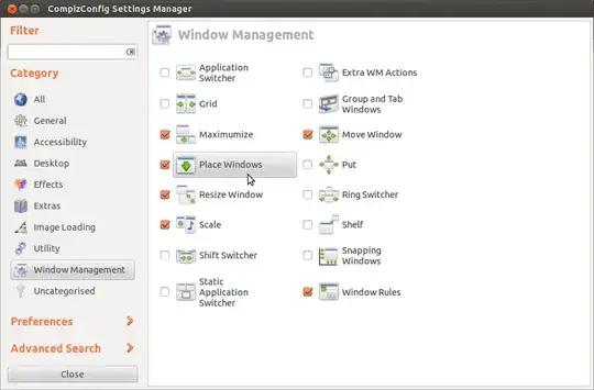

  2. Open CompizConfig Settings Manager (also known as CCSM).
  3. Choose Window Management from the left-hand menu.
  4. Choose Place Windows from the right-hand side.
    CCSM Place Windows

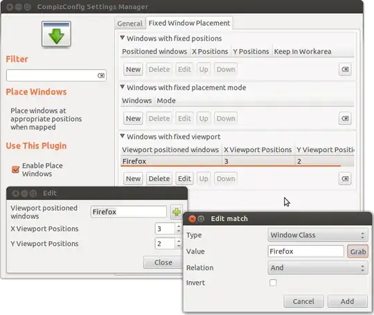

Now, for each application whose window you want to place in a fixed viewport:
  1. Open the application.
  2. In CCSM, under Windows with fixed viewport, select New.
  3. Press the big green + and then Grab. The cursor changes to a cross; click on the application window you want to fix (e.g. Firefox). The Value will be automatically filled in.
  4. Press Add.
    Getting to the Grab button
  5. Fill the X Viewport Positions (should be singular); this refers to the workspace number counting from the left.
  6. Fill the Y Viewport Positions (should be singular); this refers to the workspace number counting from the top.

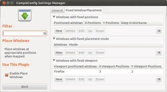

    In my example, I have chosen Firefox to always start in the third column, second row of the available workspaces.
    Firefox example
  7. Press Close.
Thereafter, that application will always open in that specific viewport.
