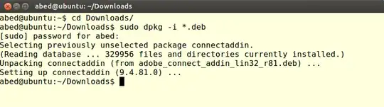

I don't use Adobe connect, but here is what I did. I downloaded Adobe connect add-in 8, and I installed on Ubuntu 13.04. I just press Ctrl+Alt+T on the keyboard to open Terminal. When it opened, I navigated to where the file was downloaded, in my case it was the Downloads folder, and I ran the following command:
sudo dpkg -i *.deb
Screenshot of the installation window:
Make sure that you have flash installed and setup on the machine prior to installing the add-in. Hope that helps.
