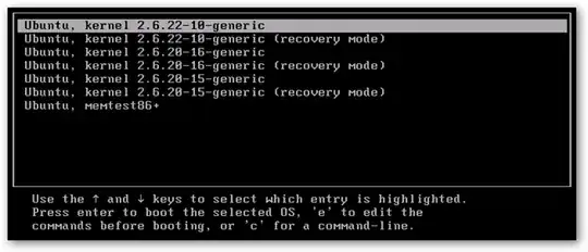

GRUB main menu with a selection of Ubuntu kernels with recovery mode options and memtest
Then you'll be prompted by the GRUB menu which can contain a list of the operating systems installed (in the case of dual boot), or the different kernels installed in a Linux system.
