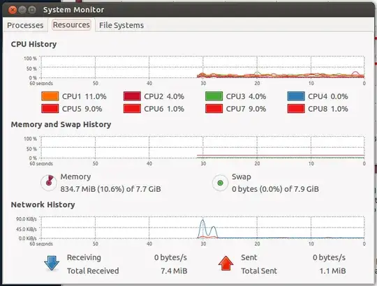

I wonder if it might have something to do with my swap partition, so I am posting this capture of my system information:
