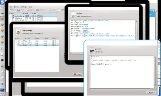

Edited to add: I'm viewing the contents of the .deb file with ark, Kubuntu's default tool. It contains only three files: control.tar.gz, data.tar.gz, and debian-binary. data.tar.gz contains the directory tree that appears to match up to the usual root filesystem, with /etc, /lib, /sys, and /usr directories. (Looking at other .deb files on my system, this structure appears to be typical.) Here's a screenshot:
Ark window with contents of data.tar.gz.
(Full size.)
Here's another screenshot showing that control.tar.gz contains three files, one of which is empty:
Ark windows showing the rest of cybergene-fujitsu-usb-touchscreen_112fdb75b406-1_amd64.deb.
(Full size.)
Here's the actual .deb file: https://www.dropbox.com/s/odwxxez0fhyvg7a/cybergene-fujitsu-usb-touchscreen_112fdb75b406-1_amd64.deb

There is a known issue with checkinstall that generates file system errors such as you have demonstrated above. In my own usage of checkinstall I routinely use the following option with my command line to get around a probable bug:
sudo checkinstall --fstrans=no
The man pages give this:
--fstrans
Enable/disable filesystem translation. Filesystem translation enabled causes the install to proceed in a temporary directory, thus not actually touching your system.
Not a satisfactory solution but until the bug is fixed it seems to be required...
