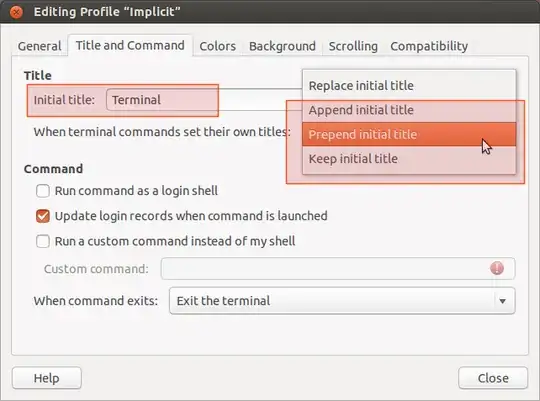

The script from the question it works perfectly, but the problem is with your terminal window title which doesn't contain the word (string) "Terminal". To get over this "inadequacy", you have three possibilities:
  1. Make your terminal window to contain the word "terminal". To do this, when you are in terminal, go to EditProfile Preferences (or press Alt+E and then O), select Title and Command tab, and follow the instructions from the below image:
    terminal title
  2. As I see in this image, your terminal window title is the same as your terminal prompt. So, the script will work as expected if you run using the following command:
    /home/michael/Scripts/bring-all-windows.bash michael@michael
    (you don't need to prepend the above command with bash).
