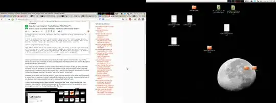

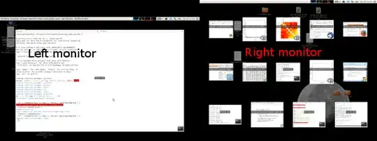

I think it might be due to the "place windows" options and the "scale" plugin options that I use together. You see, when I initiate window picker for all windows, most of the windows, for some reason, get minimized on the right hand monitor, like this:
Then when I select one of the windows on the right, the cursor is on the right hand side of the screen; and so maybe the "place window" plugin gets called and puts the window there (because it is both, the active device and the device with the cursor). So here is a before calling window picker and after calling window picker screenshot:
Before:
Then I use window picker to switch to a window on another workspace, and again to switch back to the initial workspace with the firefox window:
After:

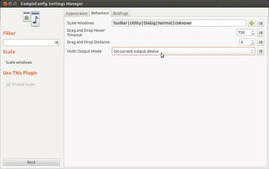

I have a suggestion you might try. Launch Compiz, go to Windows Management, and click on Scale then click on the Behaviour tab.
Check to see what your setting for "Multi Output Mode" is. Try setting it to "On current output device" and see if that helps any...
I hope this helps... Good Luck!
