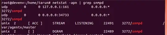

Did netstat here is a screenshot
Snmpd netstat

Edit the file /etc/snmp/snmpd.conf. Change the line:
agentAddress  udp:127.0.0.1:161
to:
agentAddress  udp:161
Then restart snmpd:
sudo service snmpd restart
It should listen to all interfaces now:
$ sudo netstat -ulnp | grep 161
udp        0      0 0.0.0.0:161             0.0.0.0:*                           8517/snmpd
