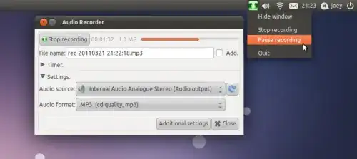

Now, there is a simple small utility that can record to mp3 anything which plays through your speakers, and therefore from your web browser, called Audio Recorder:
Audio Recorder
To install it from terminal, run the following commands:
sudo apt-add-repository ppa:osmoma/audio-recorder
sudo apt-get update && sudo apt-get install audio-recorder
Source: http://www.omgubuntu.co.uk/2011/03/audio-recorder-for-linux-easily-record-audio-streams-to-mp3
