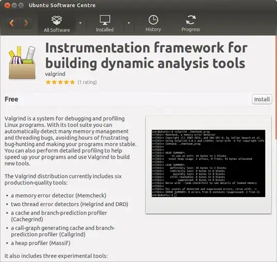

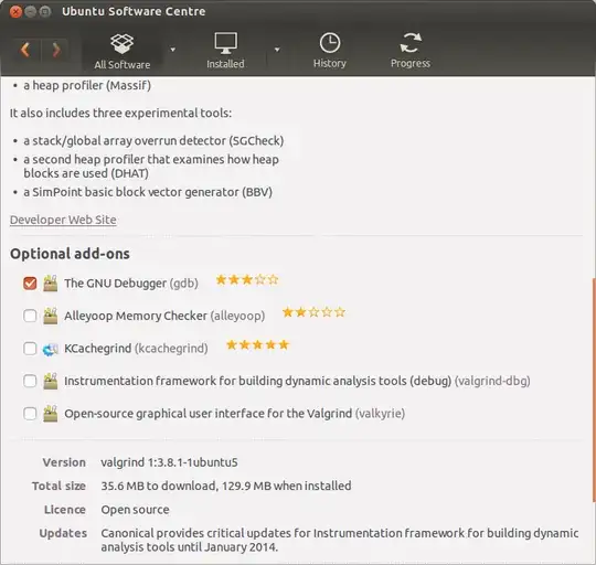

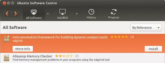

It may be better to install it from the Ubuntu Software Center. Search for valgrind
This would allow you to install the main programme
and any other additional packages which may be relevant.
