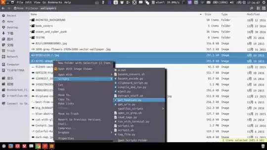

Custom Nautilus Script
While there are a few existing utilities, one can always write a script to perform such task, which is what I did. The script presented below is written in Python 3 and uses built-in functions to perform hash sum calculations of multiple types of hash, and displays the result in zenity text view window.
Usage
First set up the script. Save the script source code as file in ~/.local/share/nautilus/scripts folder. In my example, I've saved it as get_hashsums.py. Make the file executable via GUI options or via chmod +x command in terminal.
At this point the script is accessible via right-click menu, and will be available in Scripts submenu.

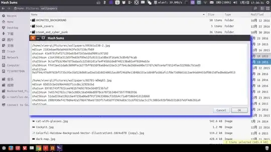

When you click on the get_hashsums.py , the script will perform all the necessary calculations and display zenity text view window with all hash sums that can be done via hashlib.
Script Source code

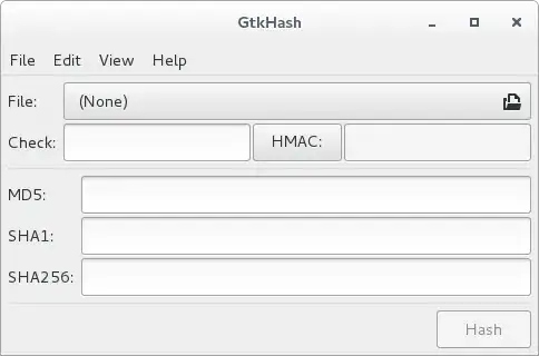

One desktop-independent solution is GtkHash:
A GTK+ utility for computing message digests or checksums
If you're using Thunar, then you may as well use the thunar-gtkhash plugin. It works similarly to the Nautilus extension.
