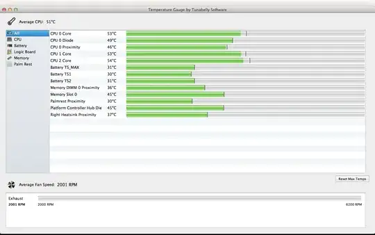

This is the stabilized OS X temperature report, while just navigating with chrome:
OS X temperature reports

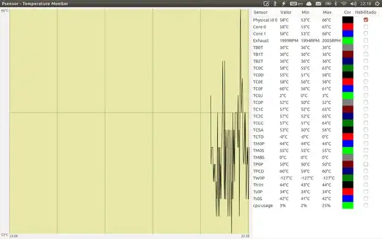

This is what I get from Ubuntu just upon start:
Ubuntu temperature report upon start

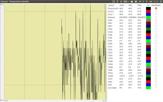

But this is what I get stabilized after using the system for some time:
Ubuntu temperature report stabilized
The sad part for me is that, differently from OS X, now I always feel the machine warm, even idle. It's not burning, but I feel my hands siting over something that's aways warm, that's not right (I recall very old notebook models which I used that aways felt warm), on OS X, I would feel such only when doing intensive tasks. By the way, I'm not with fans running loud or something like that, just the temperature that is above, and they run loud as usual, when I start steam to play some game =)
Any tip on how to solve this, if possible? I think I've described all the software I've installed that could help with this, but none helped much...

Well, my last change was to enable EFI mode. I must do some more tests, I'm running it from battery and I think it got a good enough temperature. When running plugged to the energy source I think temperature elevates.
UPDATE 2
I think it's better after enabling EFI mode, maybe I can't get better than this, the only thing left that comes to my mind is undervolting.
UPDATE 3
I'm now using ArchLinux with general power management tools like TLP, PowerTop (with services enabled) and macfanctld. It's much better than when I used Ubuntu. This is the best upgrade I've done to this machine years back. RECOMMENDED.

It may be best to uninstall mbpfan and install macfanctld from the mactel repo. In General it should use higher speeds and is therefore louder but keeps your MacBook cooler. You can configure it to suit your personal taste by editing /etc/macfanctld.conf
The most plausible is install a newest kernel. Actually, the IRC series and 3.11.1 looks better for your hardware.
I'm running in a good enough temperature by now. By the way, EFI boot is much faster.
I continue to use mbpfan, and fear a custom compiled update to a very recent kernel.
oblitum
  • 1,727
I would try resetting your SMC. This can help with system performance, fans (heat), and power issues. http://support.apple.com/kb/HT3964
