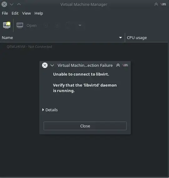

Detailed error message
Unable to connect to libvirt.
Failed to connect socket to '/var/run/libvirt/libvirt-sock': Permission denied
Verify that:
 - The 'libvirt-bin' package is installed
 - The 'libvirtd' daemon has been started
 - You are member of the 'libvirtd' group
Libvirt URI is: qemu:///system

Rebooting the system where virt-manager is installed solved the issue.

An alternative to reboot/logout is to run the following commands from a terminal:
newgrp libvirt
virt-manager
The newgrp command allows the user to join the libvirt group without logout, for processes that are started in the same shell after newgrp. Of course this only works if the libvirt installer put you in the libvirt group, which you can check with:
getent group libvirt

For me, the error was caused because group membership changes don't apply without a logout-login (or reboot). I had just installed KVM and libvirt-bin. The installer automatically added my user to the libvirtd group, I had restarted the libvirt-bin service, but I was still getting the error.
Don't change file permissions to 777. Don't just run everything as root or sudo to avoid understanding what's wrong.
Simply logging out and back in resolved the problem by applying my new group membership.
Assuming you just installed libvirt-bin and already confirmed that your current user is a member of the libvirtd group as the error message suggests, you will need to log out and back in for the new group membership to apply.
I hope this helps someone.
