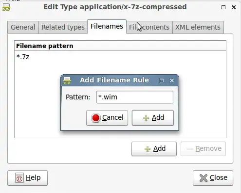

  • Open it in Menu > System Tools > File Type Editor
  • At it, go to Type > Find (CTRL+F, or search icon), type "7z".
assogiate1
  • Select x-7z-compressed, go to Type > Edit
  • Go to Filenames tab, click on Add button
  • Type *.wim, click Add
assogiate2
  • Close all dialogs, and presto!

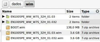

  • Nautilus now show the WIM archives as a 7-zip archive. Which, given that is 7-zip that handles them, it is not entirely false. No renaming needed, filenames are intact.

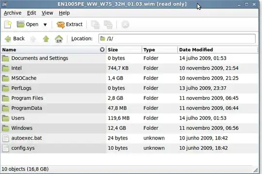

  • Double-click them, and good ol' Archive Manager opens them with no complains. No need of wine or any weird GUI

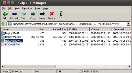

the .exe from the download site (link above) installs OK under wine (I'm using wine 1.3) - so you can browse the wim using a GUI:
Googling around, a native linux GUI is in short supply - here is one I've found, but I haven't tested this one myself
