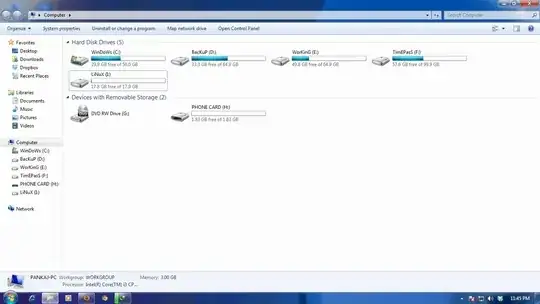

I know exactly how to install Ubuntu by Wubi alongside Windows 7, but actually as have free space and want to install it on the last drive, how can I tell Ubuntu to be installed on drive "i", means what I'm seeing is sda lyk stuff...
All I want to know is how can I install
  1. on last drive "i"
  2. along with working Windows 7
  3. without deleting or formatting other drive, as I have important and useful data there at present.
drive "i" is free and has 17GiB My drives

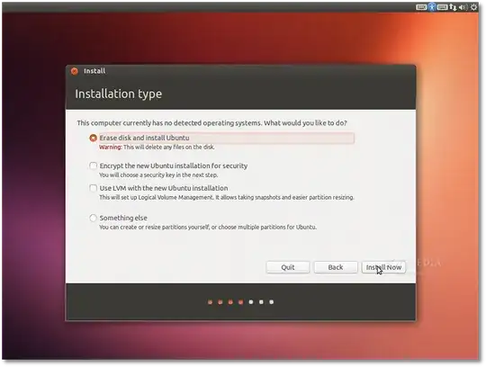

  3. Then started installation normally till it asks for Where to install like shown below -
Image taken from softpedia.

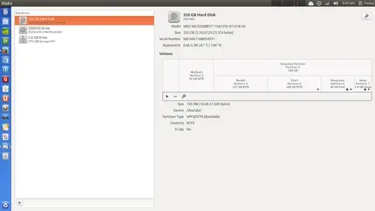

4.Then after clicking the option Something Else , it was showing all my partitions along with Free Space
5.I used Free Space where I wanted to install it without afecting others and Entered the values for making SWAP Area as 4gigs as I am having 4gigs of ram ,and rest all for root directory(/) where everything is about to be installed.
6.After everything completes , I got what I want as shown below-
Here
7.Remember in my question I was asking to do so with 17 gigs of partition , and in the picture its 47gigs , because i have changes the partition size for that, Its better now.
