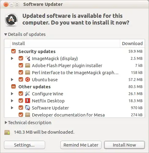

I don't think there's a definitive answer here, but Ubuntu takes care of that for you. By default, Ubuntu is pre-configured to run the command apt-get update every now and then. That is why, if you leave Ubuntu for a while without updating or upgrading it, you'll see a box like this:
It ran apt-get update in the background, and it identified that there is software that needs to be upgraded. All you need to do is hit Install Now, and Ubuntu should start downloading and installing. Clicking Install Now is just the equivalent of doing apt-get upgrade.
